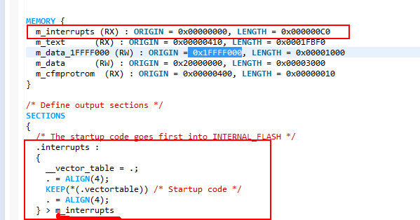

Hello Shailav,
Do you want  save the receive data  at one specified address (for example 0x00) in salve ?
then send the data of this place ?
If yes, you can use the relocate data function place the array OutData[i] to one place , for example  0x1FFFF000
__attribute__ ((section(".myRAM"))) int OutData[10];
In the linker file :
.mySection :
*(.myRAM)
} > m_data_1FFF0000
About the detail please refer to  Relocating Code and Data Using the CW GCC Linker File for Kinetis
Please pay attention that we can not place the array to the address 0x0000, for in this place it save the interrupt
vector :
Hope it helps
Alice
