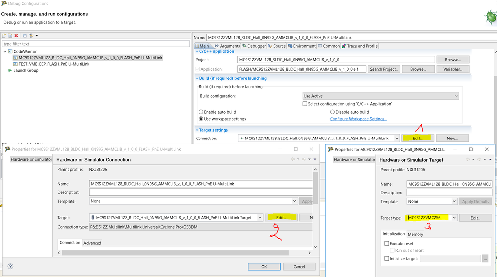

My customer (Sonceboz) cannot debug anymore while initializing S12ZVMC EEPROM.
I have also reproduced it myself:  CW11.x crash when trying to flash a .elf file containing const value while debugging.
So debugging is not possible anymore if using "const".
This is not the case when Flashing the .sw file using "Flash file to target"  menu.
I use CW11.0 + P&E Multilink FX + S12ZVMC EVB.
Find attached the project to reproduce the behavior
Const is define as :
#pragma CONST_SEG MY_EEPROM
   volatile const long  EEP = 0xAA;
#pragma CONST_SEG DEFAULT
and     MY_EEPROM   INTO  EEPROM;  in the *.prm file
if    "MY_EEPROM INTO   EEPROM" is removed the crash does not occurs .
Did I miss something ?
Thanks in advance for your help

I have dug a bit more with this issue and it appears that it is linked with MCU configuration file
Using my S12ZVM128 init file I get
INF: CMD>PM
INF: Programming and Verifying.
INF: Processing Object File Data ...
INF: .
INF: Programmed.
INF: CMD>VC
INF: Verifying object file CRC-16 to device ranges ...
INF:    block 00FE0000-00FE006F ...
INF: Ok.
INF:    block 00FFFFFD-00FFFFFF ...
INF: Ok.
INF:    Checksum Verification Successful. (Cumulative CRC-16=$624B)
INF: CMD>RE
INF: Initializing.
INF: Target has been RESET and is active.
But with S12ZVMC256 init file I get
INF: CMD>PM
INF: .
INF: Programmed.
INF: CMD>VC
INF:    block 00100000-00100003 ...
INF: Ok.
INF:    block 00FF0000-00FF006F ...
INF: Ok.
INF: Ok.
INF:    Checksum Verification Successful. (Cumulative CRC-16=$23DF)
INF: CMD>RE
INF: Initializing.
In that case EEPROM (block 00100000-00100003) is programmed correctly
So this mean that default debug configuration file for S12ZVMC128 is incorrect.
Using S12ZVMC256 is correct (even for S12ZVMC128 and may be ZMVL128, TBC...)
BR,
Philippe

ZhangJennie
Hi Phillippe,
From my understanding,changing target type from S12ZVMC128 to S12ZVMC256 fixed the problem.
I just checked, if I create a new S12ZVMC256 project, the default target type is S12ZVMC256. so it's not the problem of IDE.
If anywhere I misunderstood, please contact me again.
Jun Zhang
3,067 次查看
phil74
The issue is by creating a project for S12ZVMC128 there is no possibility to setup the EEPROM.
BR,
Philippe
