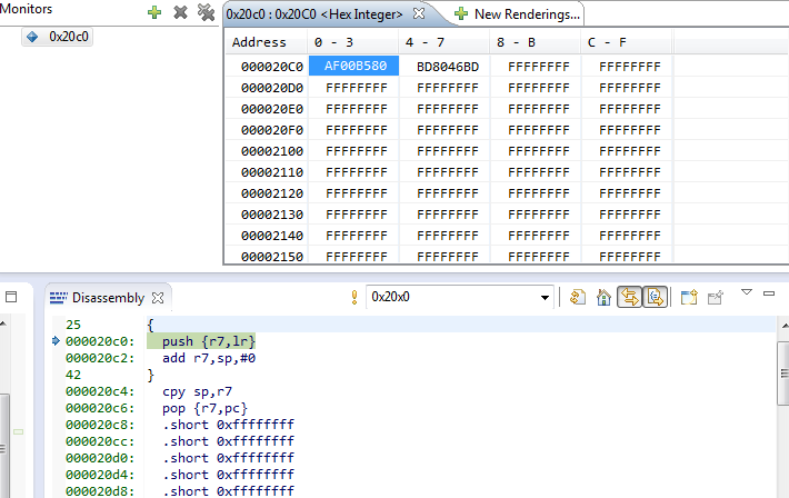

in Program code :
void hw_InitLL(void) __attribute__((section(".hw_InitLL")));
  // do some hw initialisation
  // in this example i return without any other code
if i check the linker output after building both projects, i see function InitLL at address 0x20C0 which i wanted.
When i run hw_InitLL(); in program code, then it executes fine as expected. U can see assembly and memory content in this prtscr

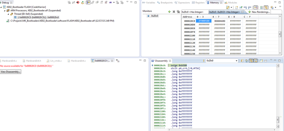

in BL code :
When i run ((void (*) (void)) 0x000020C0) (); , then it jumps to addess 0x20C0 as expected. i can see the memory content is the same, but there are other assembly instructions in disassembly window (see prtscr). When i step further i run into a hardware fault
I did use a HardwareFault component in processor expert. This gives me stacked_lr : 5159 -> "Unable to retrieve disassembly data from backend".
My Question
Why do i see the same memory content but is codewarrior not able to show these as assembly instructions?
Why do i run into a hardwarefault?

stevedecoen
Hi Alice,
No need to post parts of the code . I found the solution,
i just need to call the function with an uneven address, so 0x020C1 instead of 0x020C0
Googling, I found:
The mechanism for switching makes use of the fact that all instructions must be (at least) halfword-aligned, which means that bit[0] of the branch target address is redundant. Therefore this bit can be re-used to indicate the target instruction set at that address. Bit[0] cleared to 0 means ARM and bit[0] set to 1 means Thumb.
Thank you for the help !
Steve
