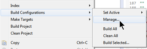

How do I make a release build?  With other development systems there is a selection for Debug and Release build selection, don't see the selection on Code warrior.

Hi Harold,
'Debug' and 'Release' (see https://mcuoneclipse.com/2012/06/01/debug-vs-release/ ) are done in Eclipse with build configurations.
You can manage them with the project menu or with the context menu on the project folder:
