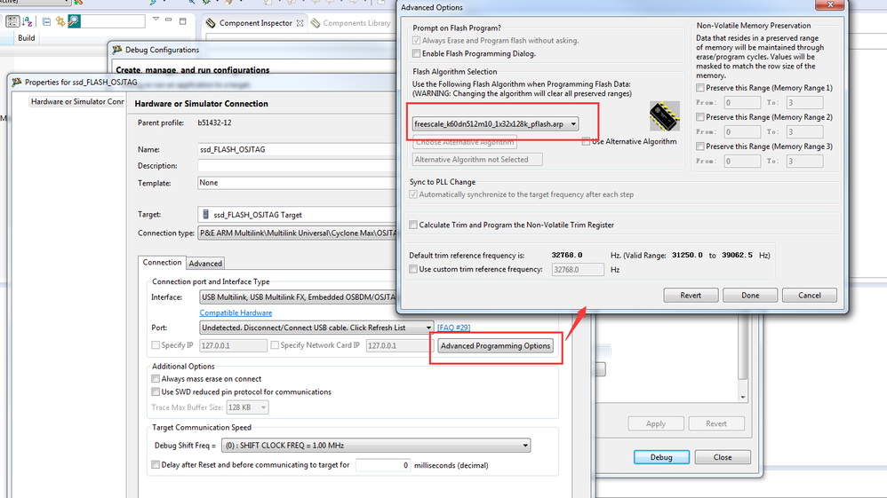

When loading the code to development board receive error message that code not erase the code.  Have reset the board and the Multilink Universal box.  I have also reset Code Warrior and the PC.

Here is more information the screen display during upload of code (or trying to) to the board:

Starting 3rd party flash programming...
GDI: Mtwks Callback(MTWKS_CB_PROJECTACCESS, Section : STARTUP, Entry : SPECIFY_NETWORKCARD_ENABLED, Value : 0, R) => DI_OK
INF: Copyright 2012 P&E Microcomputer Systems,Inc.
INF: Command Line :"C:\Freescale\CW MCU v10.6\eclipse\..\MCU\bin\de.exe" -noni -language en -ORBendPoint giop:tcp:127.0.0.1: -ORBtraceLevel 0
INF: CMD>RE
INF: Initializing.
INF: Cannot enter background mode. Check connections.
ERR: Error Resetting device for programming.

Hello Harold,
- Which mcu do you used ?
Please be sure the debug configure view is right ,  especially the Flash Algorithm:
Hope it helps
Alice
2,573 Views
haroldvogel
Please tell me how to display the above windows.  I have looked in the help files but they are of no help.  I am using an MKL36Z256VLL4 processor on the board that I am working on.
