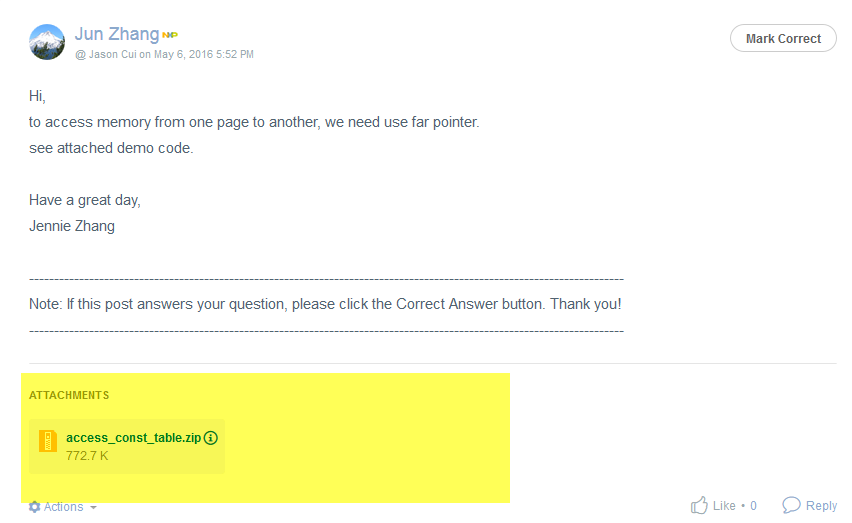

ZhangJennie
to access memory from one page to another, we need use far pointer.
see attached demo code.
Jennie Zhang

ZhangJennie
Hi Jason,
the demo code is right under my last reply. see:
couldn't you see it? if not, pls tell me your email, I will send it to you via email.
basically HCS12(x) is 16bit MCU, the default address access is 16bit. if we want to access other paged address, we must use qualifier to extend the address access pointer to over 16bit.
Jennie Zhang
