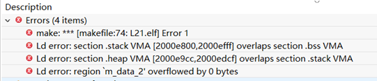

Real RAM size of my project  is  over 60k,so the errors happens as follows.
The MEMORY of S32K146  contains two blocks:SRAM_L and SRAM_U, now SRAM_U is used and  overload,but other block is not used.How can both of  RAMs  be used  at the  same time?

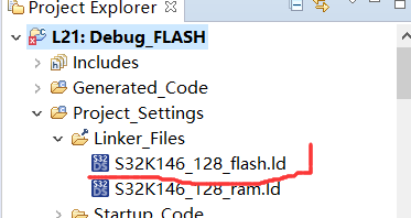

Attachment File Detail: S32K146_Flash.id

Alexis_A
What you could do is to modify the origin of the stack to m_data to place this in the SRAM_L.
/* Initializes stack on the end of block */
  __StackTop   = ORIGIN(m_data_2) + LENGTH(m_data_2);
  __StackLimit = __StackTop - STACK_SIZE;
  PROVIDE(__stack = __StackTop);
  __RAM_END = __StackTop;‍‍‍‍‍
Let me know if this helps you.
Alexis Andalon
3,333 Views
609510318
It is useful  to use next method:
__attribute__ ((section(".data")))
