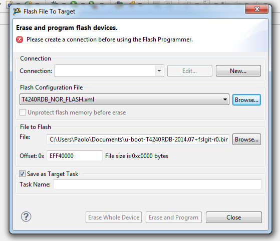

I'm trying to use the Codewarrior USB TAP and the flash programmer to flash a u-boot binary image to my t4240rdb board, but I do not know which connection I have to choose in the Flash File to Target dialog:
can you help me?
10,435 Views
lunminliang
May be you can try to run the Bareboard project with RCW override to see if connection OK. Use the T4240RDB_init_sram.tcl to be initialization file and choose CodeWarrior USB TAP to be the connection type(Both when you create the project or change the settings after creating are OK). Specify T4240RDB_RCW...-rev2.0.txt or T4240RDB_RCW...-rev1.0 in the JTAG file configuration panel, according to chip version on the board.

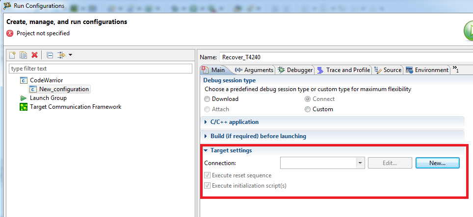

You have 2 possibilities. One is to enter in debug and then run the target task and the second is to right click on target task and Change Run Configuration from Active Debug Context to a run configuration you want to use.
Adrian
10,433 Views
paololago
Ok , I'm trying to create a run configuration and the following dialog appears:
I suppose that I have to configure a connection in the target settings box (am I wrong?)
Then, after clicking the "New" button, the following dialog appears:
Here there are several system types, but not my board ( the t4240rdb ).
The problem is that I do not know how to configure a debug or a run configuration for simply flash a file on my board and I did not find any guide explaining this. :smileysad:

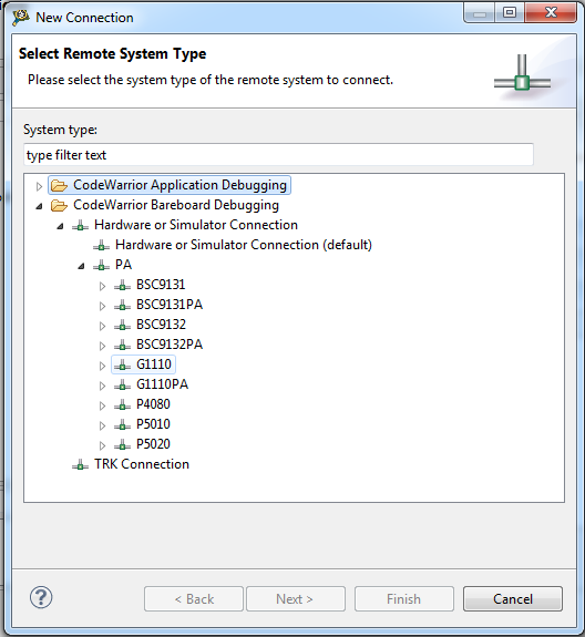

Again you have two possibilities :smileyhappy:. First one is to create a bareboard project using Wizard, and select Download/Attach as launch. Then select this debug config in "Change Run Configuration".
Second from New Connection you should select Hardware or Simulator Connection, provide a name and description. As Target go to New - > Hardware or Simulator Connection. Then at Target type expand eppc and select T4240. In Initialization tab: Select the core(s), add Initialize target file. In Memory tab add the memory file. Those files can be found in CW_PA_v10.4.0\PA\PA_Support\Initialization_Files\. Then select this configuration in "Change Run Configuration".

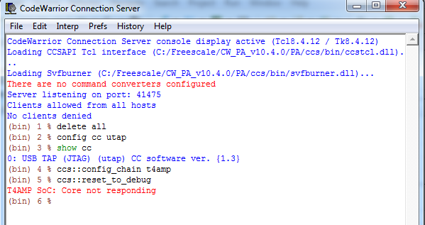

"Core not responding error" is not ok. It could indicate a hardware issue. To check this please go to CW_PA_v10.4.0\PA\ccs\bin\, open ccs.exe and enter the commands:
(bin) 175 % delete all
(bin) 176 % config cc cwtap
(bin) 177 % show cc
(bin) 178 % ccs::config_chain t4amp
(bin) 179 % ccs::reset_to_debug
If you get "Core not responding error", it is very possible to be a hardware issue with the board.

Ok. Then use:
(bin) 176 % config cc utap
(bin) 177 % show cc
Adrian
10,435 Views
paololago
I always get the same error: CC config string is invalid
10,435 Views
addiyi
Than, thy the following commands:
findcc utaps - this will display all available utap connection
findcc cwtaps - this will display all available cwtap connection
Adrian
10,435 Views
paololago
Ok the previous command finally worked, I get Core not responding:
10,435 Views
