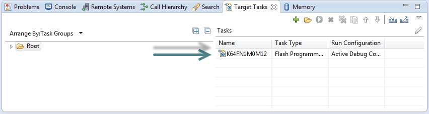

  • Add a target task view by clicking Window -> Show View -> other from menu bar, then select Debug -> Target Tasks view in the popup window.
  • From the Target Tasks view, select “Import” from the context menu. Then select the flash (.xml) file for your target device. In this case I need to select MK64FN1M0.xml file. After that you will see a “MK64FN1M0” task in the list.

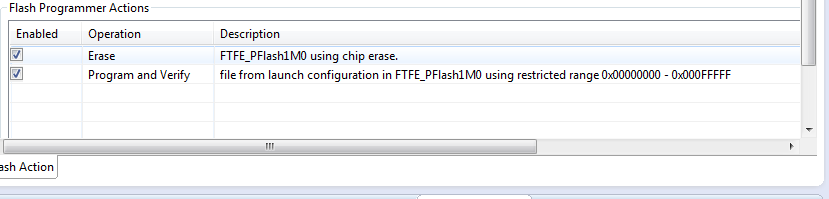

  • Double click the task name, you will see there are two actions (“Erase” and “Program and Verify”) in the “Flash Programmer Actions” view.

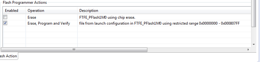

  • The default Erase action will mass erase all flash, so I remove this action by unchecking the “Erase” action. I can add erase action in “Program and Verify” action later.

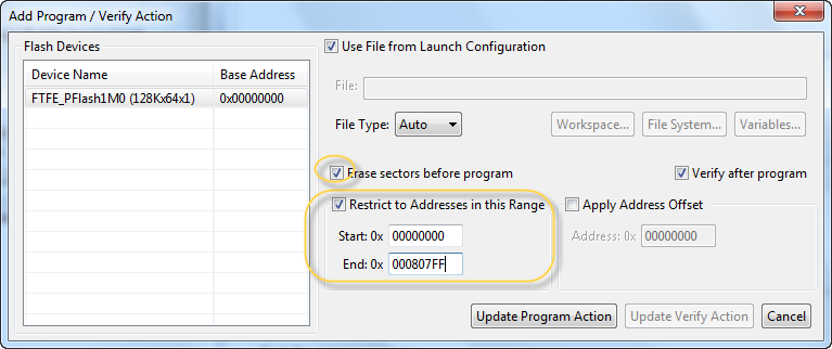

  • Double click the “Program and Verify” action. In the popup dialog, check “Erase sectors before program” option. Check “Restrict to Addresses in this Range” option, and then specify the address range you want to program. The data/code out of this range will be preserved (will not be erased or changed). Click “Update Program Action” button to update the settings of this action.

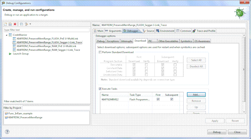

  • Move to Debug configurations window by clicking Run -> Debug configurations from Menu bar. Select a debug configuration, in this case I select the run configuration for Segger J-Link. Select Download tab which is under Debugger tab.
  • By default, Standard Download will be executed and all the flash will be erased. As I am going to execute target task in this case, so uncheck “Perform Standard Download” and then check “Execute Tasks”. Click “Add” button to add a task. In this case I add K64F1M0M12 task which I created in previous step in target task view.
