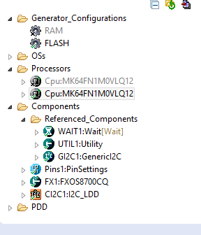

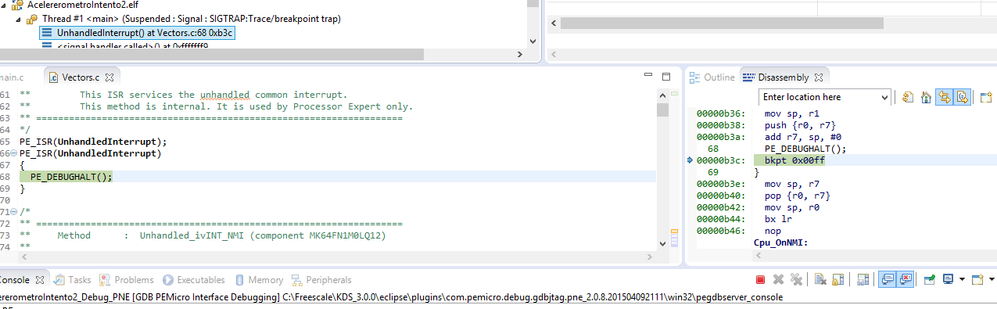

The project does not have problems but the debug stop and not advance, it is what appear me
I saw about 300 pages trying to solve this but I could not.
This is the components that I am using in the project.
Please somebody can help me?, I will be very thankful for whatever help.

Carlos_Mendoza
Hi Daniel,
There could be many reasons of why your code is going to the unhandled interrupt. Please take a look to the following post created by our colleague Erich Styger, it gives some guidance on how to find what is causing that hard fault:
Debugging Hard Faults on ARM Cortex-M | MCU on Eclipse
Hope it helps!
