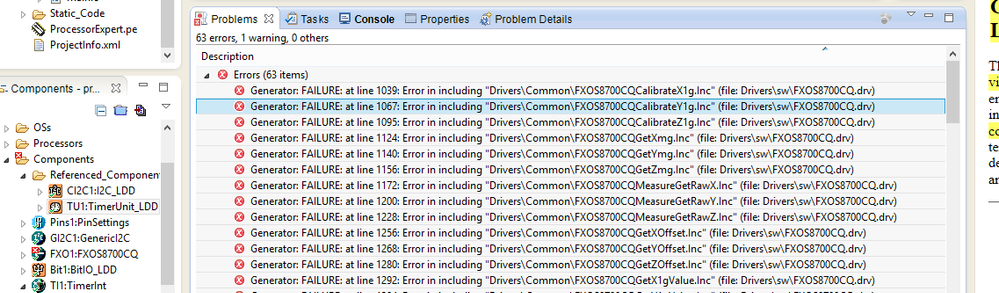

I follow your instructions but when  I pressed the button generate Procesor Expert Code it generates 63 errors:
DescriptionResourcePathLocationType
Generator: FAILURE: at line 1067: Error in including "Drivers\Common\FXOS8700CQCalibrateY1g.Inc" (file: Drivers\sw\FXOS8700CQ.drv)pruebaFinalFXO1Processor Expert Problem

BlackNight
have you loaded the Processor Expert component Components 2015-03-22.zip from SourceForge here:
McuOnEclipse - Browse /PEx Components at SourceForge.net

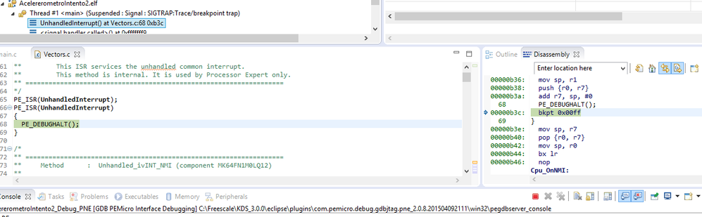

I solve all problems in the kinetis changing some thing, I wonder if you can help me with another question when I drag  FX1_Enable(); to the main and I debug  appear this
I am trying to use the accelerometer of the FRDM-K64F can you help, I would like to use this component but I just receiv errors.
I will be thankful if you can help me again.
