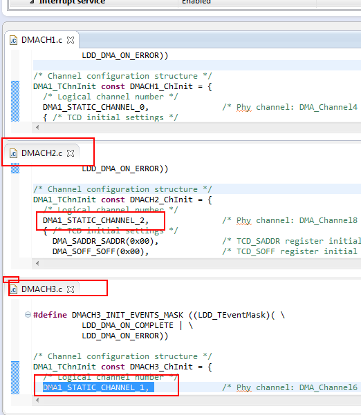

I have K60F120M tower board.
I have issues with ISR event callback problem and want to remove the DMA controller and regenerate through PE. But after I removed DMA controller, I couldn't put it back as the same as before. I copied back the saved version, but The order of the channels in the Property page (attached) is not Chan 0 to Chan 3.
which creates a huge problem for me after PE generated code.
All channel numbers are reassigned into a different number, e.g. DMACH1 should be DMA1_STATIC_CHANNEL_1, but it reassigned to DMA1_STATIC_CHANNEL_3 even the Channel is chan 1 in the DMA1 controller as shown above.
The green line is new code generated by PE and the red line is removed/changed from previously generated code.
How to fix it?

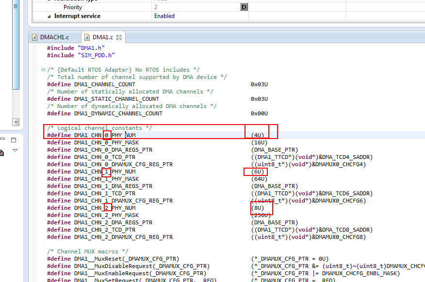

Hello David,
This is just one logical channel, not the actual physical channel.
It meaning, this is just stand for the sequence of configure the DMA channel,
for example , we add three channel , at start , in turn to configuration : DMACH1 ,2, 3,then
from the DMACHx.c file , we can see they are in turn :
If then you change one , for example the component of DMACH2, we will see that ,
in the DMACH2.C file , the logical channel number become 2, not 1 , while in the DMACH3.C file ,
is "DMA1_STATIC_CHANNEL_1, ", the reason is we last configure the DMACH2, so the his logical nummber
is the last :
While it doesn't matter , the actual channel control is at the DMA1.C FILE :
they are one to one correspondence.
If you think this is confused , i recommend you if change one channles configure, you can from the first one ,then change all of them one by one , only need change one place on each channel, for the do not need changed
channel , you  change it to other , then change it back .
Hope it hleps
Alice

Hello David,
About the DMA channel configuration , please configure the component of "DMAChannel_LDD":
Not on the DMAConroller.
Hope it helps
Alice

Hello David,
is the last :
Hope it hleps
Alice
4,819 次查看
davidzhou
Contributor V
Hi Alice,
Thank you for your input.
I think if the program only uses the code generated by PE, this is OK and it will work. I know these numbers are logical. But if logical matches physical will be less confusion and less prone to error/bugs, because if the code is modified and using the macros, such as DMA_TCD1_CS,
    pDMA->SERQ = DMA_SERQ_SERQ(DMA_CHANNEL1);
then all these codes need to be modified again. The logical numbers are shuffled by PE.  I think I need to make such modifications for my customized code.
Thank you for your support.
David Zhou
