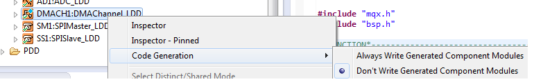

I have used PE to generate code for some components. I have made changes to PE generated code. And when I add a new component using PE, I don't want PE to regenerate the code for previous modified components and only for newly added components. I had code generation disable with Don't Write Generated Component Modules as below:
But I found that code is also generated for those components.
What did I miss? Or any other way to disable code generation?

I just checked under my CW10.6.4, Don't Write Generated Component Modules works normally.

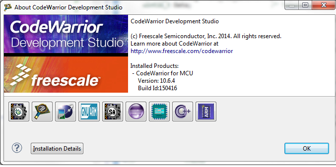

My CodeWarrior is also 10.6.4:

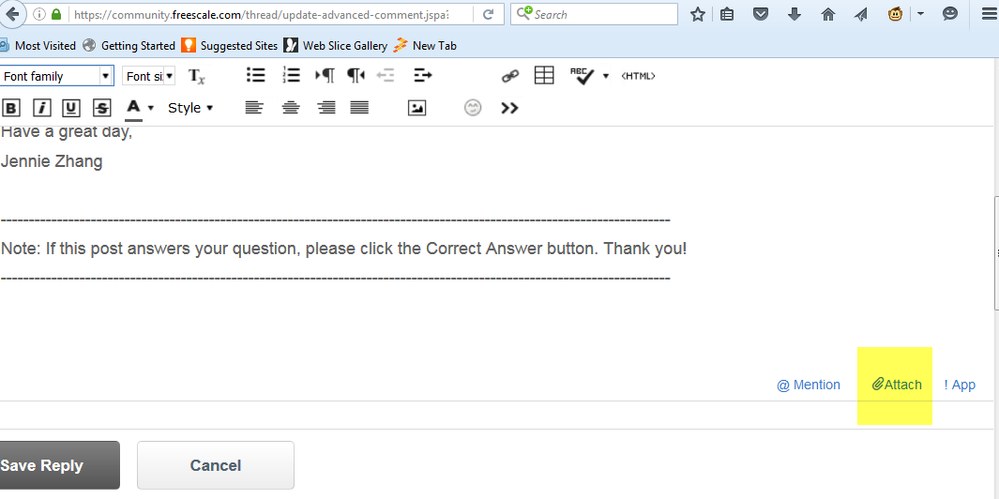

My NXP Community Web Page has problem with uploading. I cannot attached files for uploading, which has been never resolved itself. In ACTIONS command list, it doesn't contain upload or edit. Or I don't know how to upload a file.

after you click on "Actions", "Edit", you can up load your attachment here:

It seems that not always re-generate if it is disabled. Not all disabled are regenerated. It seems random as far as which file(s) will be regenerated, under some conditions they are regenerated. I have GIT checked in for the project, and the files can easily be identified.

I tried original installed bsp: bsp_twrk60f120m.wsd under C:\Freescale\Freescale_MQX_4_2\mqx\build\cw10gcc\bsp_twrk60f120m.
It works, and if code generation is disabled, it doesn't generate the code again.
So the issue might have something to do with the Cloning wizard.
