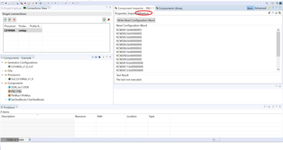

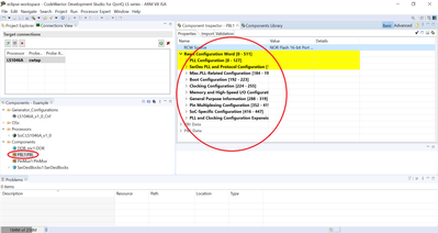

You can Read/Write the PBL RCW in the Code Warrior.
You have to click on PBL1:PBL at the bottom left on the window "'components"' and then in the part of properties in the right you can configure the PBL RCW.
In the window "'validation"" you can write the new configuration to your device.
And if you prefer import a configuration you can read a device too.
