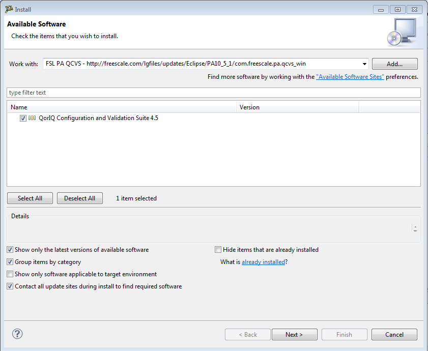

Hello All,
I am beginner for freescale processorsand handling first time T1024 processor. Can any body tell me how to open RCW configuration settings on Codewarrior tool?? I'm not able to find how to create QorIQ project in Codewarrior 10.5.1 tool.
Help would be highly appreciated..
Gourav

addiyi
You have to install QCVS on top of CW for PA. For this you have to go to Help > Install New Software and select as updatesite: FSL PA QCVS - http://freescale.com/lgfiles/updates/Eclipse/PA10_5_1/com.freescale.pa.qcvs_win.
Adrian

addiyi
That link can be use only in Help > Install New Software. So, open CW and go to Help > Install New Software, select the link and the QCVS 4.5 as in below image.

gouravjain
Hi Adrian,
After downloading around 40-50 % (not only QCVS tool even plugin also) im getting below error,
An error occurred while collecting items to be installed
session context was:(profile=PlatformProfile, phase=org.eclipse.equinox.internal.p2.engine.phases.Collect, operand=, action=).
Unable to read repository at http://freescale.com/lgfiles/updates/Eclipse/PA10_5_1/com.freescale.pa.qcvs_win/plugins/org.eclipse.....
Read timed out.
Pls help me out from this problem .
Gourav

addiyi
CodeWarrior for PA 10.3.3 doesn't provide support for T1024. Please use 10.5.1. Also, about the QCVS installation please try again or search on nxp.com/qcvs the offline installation package.

gouravjain
Hi Adrian,
Thanks for your prompt help. Now i followed offline way to install QCVS and it worked in my system.
Gourav
