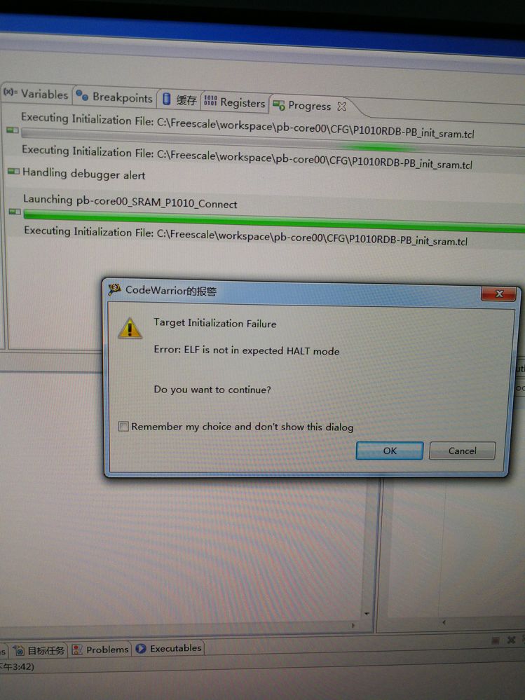

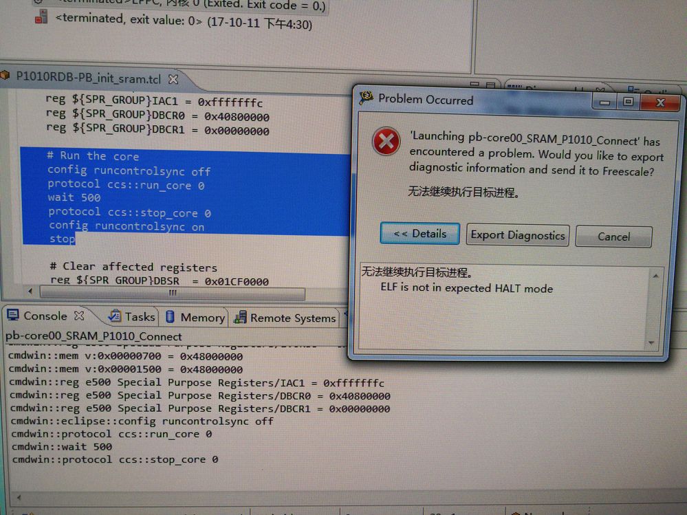

Dear all!
I tried connect to the p1010NXN5HHB target board in SRAM mode in the CW10.5.1 environment using the p1010RDB_PB DEMO  program. JTAG can initialize successfully. But when initializing the "/CFG/P1010RDB-PB_init_sram.tcl" file, "Error message: ELF not in expected HALT mode" Problem occurred .
I'd welcome any suggestions.
Original Attachment has been moved to: p1010-pb-core00.rar
Original Attachment has been moved to: log1.txt.zip
Original Attachment has been moved to: log.txt.zip

See attached file.
Do you use the same configuration for using P1010 SRAM?
