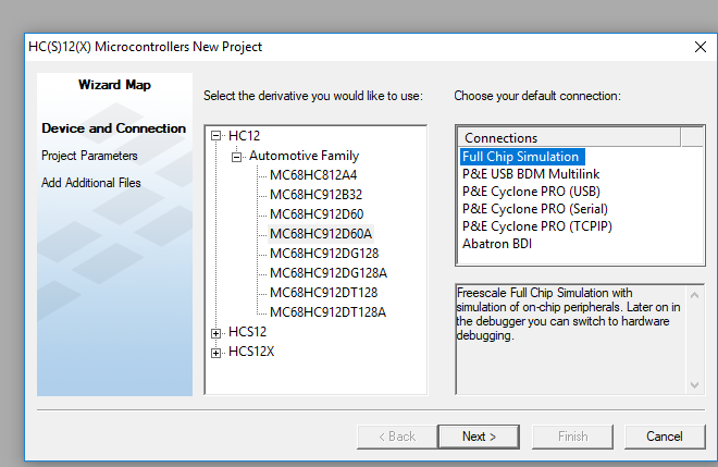

How do I get P&E Micro USB multilink debugger to work.  The only thing I have available for the MC68HC912D60A is Full Chip Simulation but for every family other than automotive, P&E Micro is included.

Hello Paul Arcuri ,
How about reinstall the CW IDE?
I check on my side, CW5.1, it work well :
