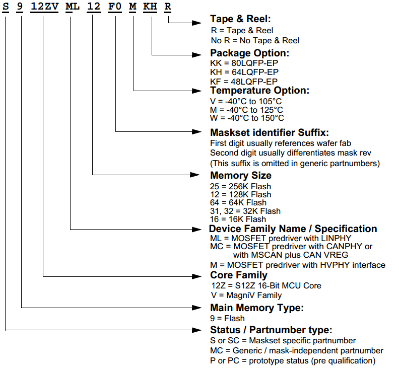

ameliafeng
Thank you for your reply! I had never found this part number before.
Now I have bought some sample chips named PC9S12ZVML12MKH. According to the  ordering information in the datasheet,I think  the chip name should be  PC912ZVML12MKH. It makes me confused.
Another question:
2,515件の閲覧回数
ZhangJennie
No,  PC9S12ZVML12MKH is prototype version (start with P or PC).
Once S or SC version is released. PC version dies.
Jennie Zhang.
