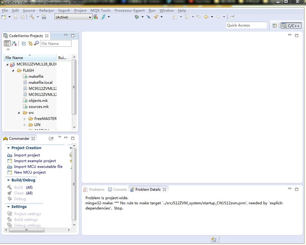

I just Run CW MCU v10.6 and  imported a project from another place.After Buid,the following error occurrs:
mingw32-make: *** No rule to make target `/src/S12ZVM_system/startup_CW/S12zvm.prm. needed by explicit-dependencies . stop.

Thanks a lot for contacting us.
Please click on <Project> menu -> Clean to rebuild the project.  Does the error disappear? If the project contains Processor Expert, please right click on the file "ProcessorExpert.pe" and select "Generate Processor Expert Code", then clean and rebuild the project.
Hope it helps! If not, please attach your project folder, thanks!

that message is caused because the make file cannot find a file and/or fullfil a rule (see https://mcuoneclipse.com/2012/03/12/no-rule-to-make-target/ ). As Fiona indicated, usually a 'clean' solves that because it recreates the make files.
Can you check if that linker parameter file (/src/S12ZVM_system/startup_CW/S12zvm.prm) exists in your project?

sufree
Your suggestion solved my problem perfectly.
Thank you !I
