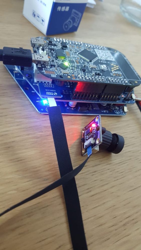

I am a participant in the NXP CUP.
The problem is that I can't open line scan camera (linear CCD camera) with the FRDM KL25Z board.
I tried  to open the camera but no success.
(the red led does not  mean that the camera is working well?!)
And I checked if the problem was from the serial communication but I send data using the SDA mini usb port successfully.
So I think the problem is in the camera itself, but I do not have any idea how to solve this problem.
Please, I need a solution as soon as possible!
Thanks in advance.

Solved! as mentioned in the README.pdf file here NXP FRDM-KL25Z Support Package Update - File Exchange - MATLAB Central .

we have encountered what I believe is a similar problem.
We wanted to test the camera on TFC-TEST_UPDATED_HW - Example program that tests CCD1, Servo 1, and b... | Mbed  code from Mbed using FRDM-TFC - Updated TFC library to be compatible with the r... | Mbed  library.
But when we select to print out the input from the camera, it's similar to what we get when we unplug the camera.

Yes, this random displayed output is the same even if the camera is unplugged, so I think the camera isn't seen by the board.
Did you find any solution? @Ondřej Svoboda
