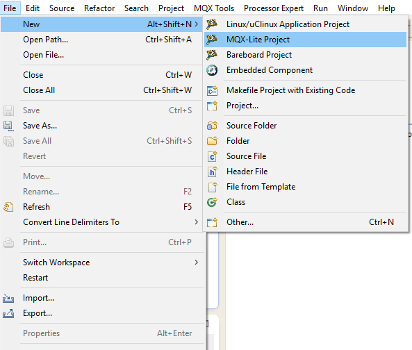

I am installing MQX4.2 for my CW10.7 Environment. I was hoping to find a Codewarrior extension in the setup which I am not able to see.The MQX setup looks this:
I have tried googling for this problem and found a solution here. The links given here are directing to NXP's home page and I am at a dead end. What I understand is that the codewarrior extensions have to be installed after installing MQX. I dont find them in the tools section either.
Surprisingly, when I try to create a new project, I see an option for "MQX Lite".
MQX Lite is not my requirement.
Is there any alternative for installing MQX extensions in CW10.7?

Hello Sarma,
After you finish the install of MQX, please install the update of MQX on CW, the steps as below:
1. Click Help menu ->Install New Software..
2. In the work with space select  FSL MCU Eclipse Update Site - http://freescale.com/lgfiles/updates/Eclipse/MCU10_6/com.freescale.mcu.updatesite
3, Select the MQX4.2 related updates refer to your requirements :
4. then refer  to the reminder to finish the installation .

This worked for me. Thanks Alice Yang. :smileyhappy:
