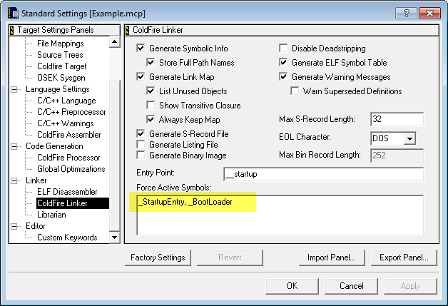

Here you have 3 alternatives to avoid the linker being "smart" with those functions:
1) Place those functions in the "Force Active Symbols" section of the Linker options, separated by a comma and with an underscore before each one. Refer to the next picture:

dougpaulsen
Jorge:
Thank you for your solutions!  I had uncovered the #pragma force_active approach late yesterday after I switch my search inquiries from bootloading, et al., to the subject of dead stripping.  I haven't completed coding my implementation, but initial testing finds my intermediate interrupt jump table is indeed being located in the desired memory map addresses.  The rest is just details, right?
