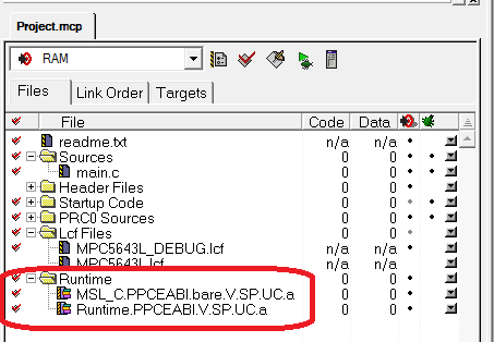

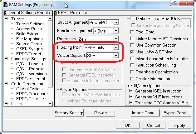

First please check your compiler floating point setup:
If you don't require double precision floating point I'd recommend you to select "SPFP_Only" option since it generate most efficient SPFP code.
Next step is to add proper standard libraries (MSL + Runtime) that match with floating point option selected.
e.g.for VLE project,where char = unsigned char, and SPFP_Only floating point selected:
Use this runtime library:
"<CW for MPC55xx and MPC56xx 2.10>\PowerPC_EABI_Support\Runtime\Lib\Runtime.PPCEABI.V.SP.UC.a"
And this MSL library:
"<CW for MPC55xx and MPC56xx 2.10>\PowerPC_EABI_Support\MSL\MSL_C\PPC_EABI\Lib\MSL_C.PPCEABI.bare.V.SP.UC.a"
For more information about the libraries available please see the Build tools reference manual:
"<CW for MPC55xx and MPC56xx 2.10>\Help\PDF\Power Architecture Build Tools Reference.pdf", sections "Choosing an MSL Library", "Choosing a Runtime Library".
Hope it helps.

zili
Hi Stan,
It's working fine now. Thank you very much.
