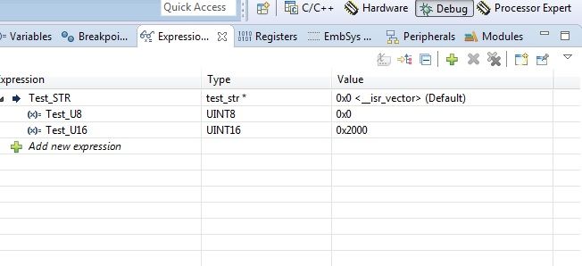

I use a MKL17Z256 Kinetis MCU and I have a problem with a code with dynamic allocation.
All is OK when I use this code :
typedef struct
       unsigned char Test_U8;
       unsigned short Test_U16;
}test_str;
test_str Test_STR;
test_str * PointeurTest_STR = &Test_STR;
PointeurTest_STR->Test_U8 = 0;
PointeurTest_STR->Test_U16 = 0;
But MCU buggs when I use this one:
typedef struct
}test_str;
test_str* Test_STR = malloc(sizeof(test_str));
The problem is the MCU fall in defaultISR in startup:MKL.....S file
DefaultISR:
    ldr    r0, =DefaultISR
    bx r0
What can cause this problem ?

I forget, the problematic lines are :
But I think to see the problem, the result of the allocation is on the ISR vectors
How can I avoid this ?

It wasn't on -Os but -O0, but I changed it to -O2.
I saw Heap Size was at 0x0000 and Heap Stack was at 0x0400. So I changed heap size to 0x0400 and it works well. I just saw in another post that change this heap size resolved the problem. Effectively it works.
I noted your advise about structure configuration.
Thank you,
