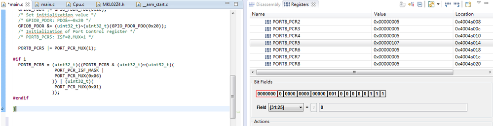

When I use below code to assign NMI pin to GPIO, it can't assign successful.
PORTB_PCR5 |= PORT_PCR_MUX(1);
But If I use below code, it can assign successful.
PORTB_PCR5 = (uint32_t)((PORTB_PCR5 & (uint32_t)~(uint32_t)
                            ( PORT_PCR_ISF_MASK | PORT_PCR_MUX(0x06) ))
                            | (uint32_t)( PORT_PCR_MUX(0x01) ));
Why I must need to clear PORT PCR ISF and set it to MUX 6 first and only in this way can the assign to GPIO(MUX 1) succeed.

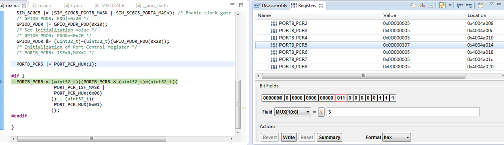

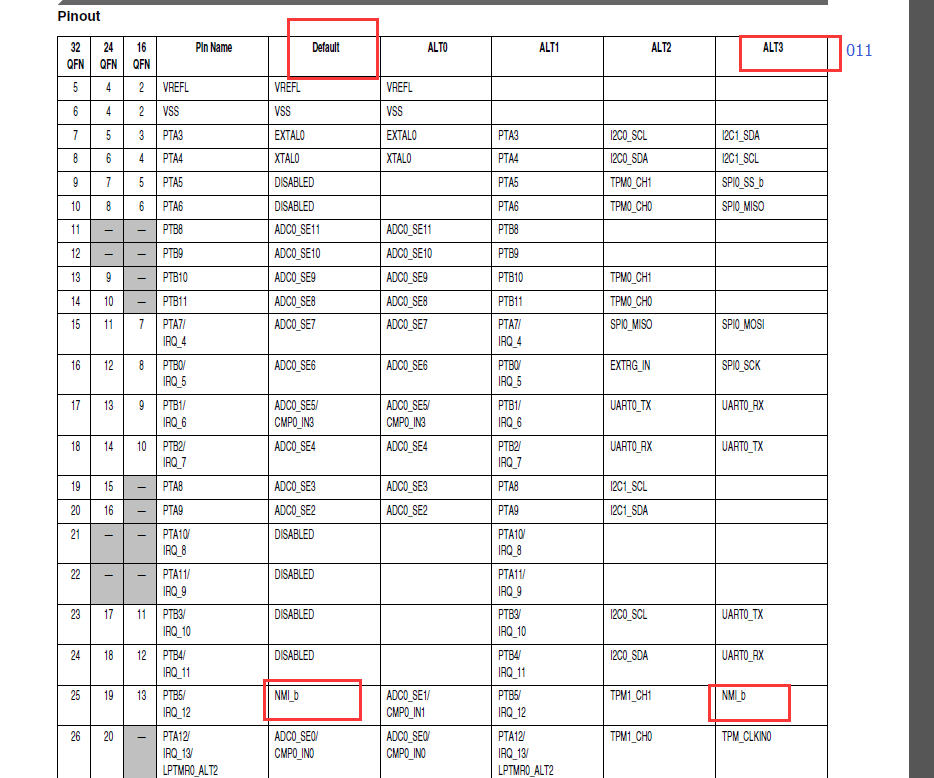

Hello Kris,
The default data of PORTB_PCR5 ->MUX is 011 :
So if you simple use PORTB_PCR5 |= PORT_PCR_MUX(1);  the MUX still "011".
We need first clear it , then set it to "001".

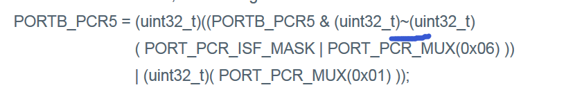

Please pay attention that in your code, there is a  negation ,
(PORTB_PCR5 & (uint32_t)~(uint32_t)PORT_PCR_MUX(0x06))  this code is clear the [9:8] of PORTB_PCR5 .
In a word , if you do not care about the interrupt status flag, you can only use the below code to configure PTB5 to GPIO function :
 PORTB_PCR5 = (uint32_t)((PORTB_PCR5 & (uint32_t)~(uint32_t)(
                PORT_PCR_MUX(0x06)
               )) | (uint32_t)(
                PORT_PCR_MUX(0x01)
Hope it helps
