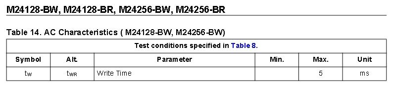

Just to add that as I stated in my last post above, I could write and read but I cannot write and read in sequence. Is there such a rule for I2C EEPROMs to write and read separately?

I received feedback for Proceesor Exper team which could explain the EEPROM behavior.
See below:
It is a feature of the EEPROM device.
Write cycle takes up to 5ms.
It is not responsibility of I2C bus protocol in general.
