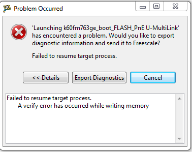

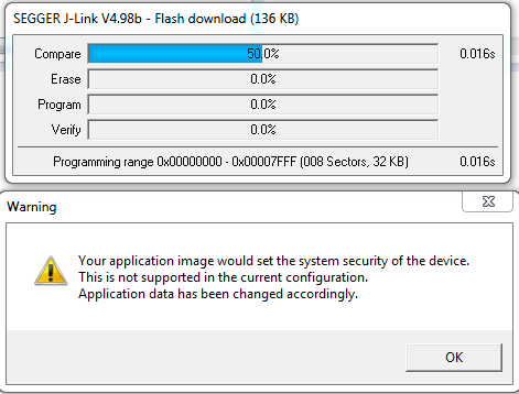

I try to use jlink under CW 10.5, but I have issue:
The configuration is:
I use the same CW10.5 and Jlink to debug the other project, it is ok, that means the jlink and the connection and the board are OK.
And I replace the Jlink with multilink, it is ok too.  So what is the probable cause for this jlink issue?

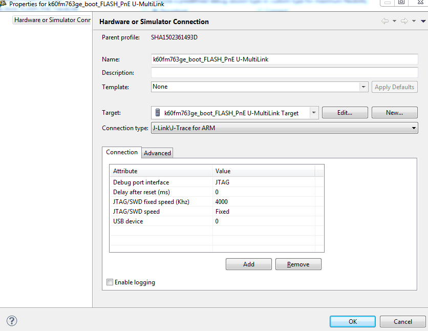

So, my question is, how to use jlink under codewarrior?
I modify the connection type to "J-link\J-trace for ARM", it works for some project, but not for the other, I really don't know why?

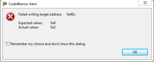

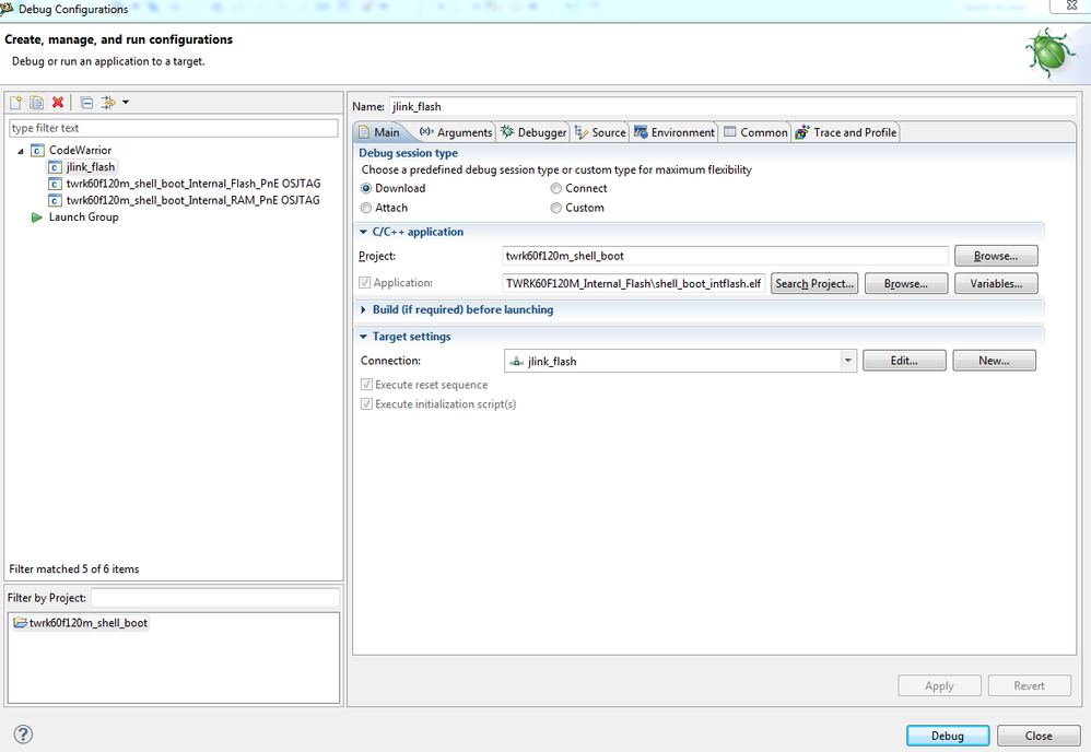

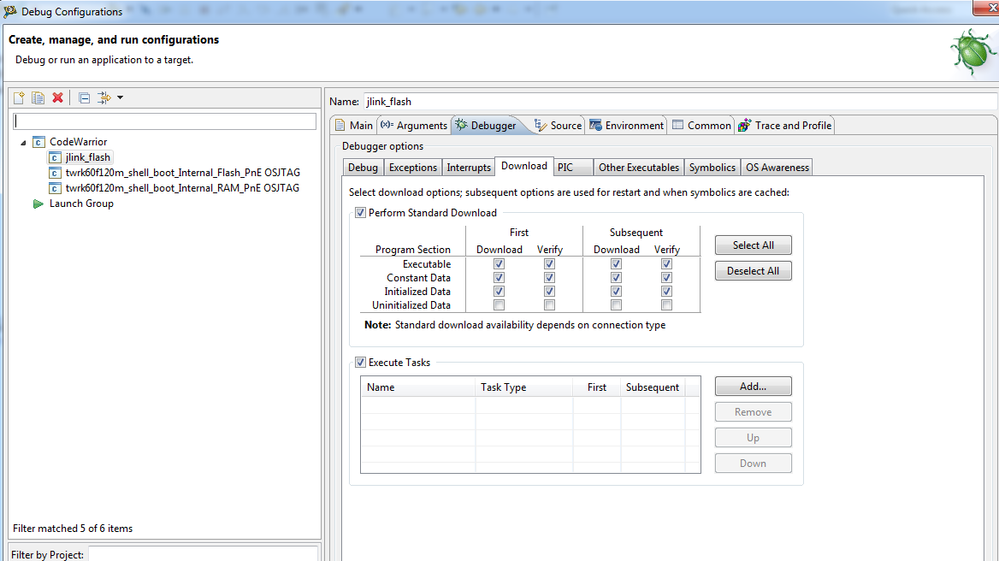

I am using development board TWR-K60F120M, and I was trying to import the fNET2.7.5 demo project "twrk60f12m_shell_boot" to CW10.5 and debug it.
I have Jlink so I create a new debug configuration to use Jlink:

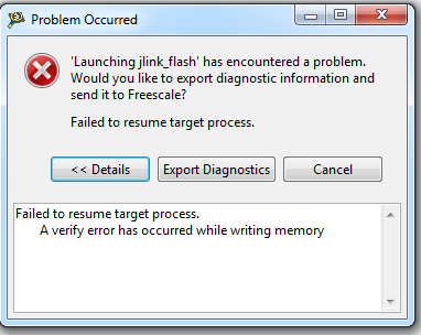

When I start downloading the target, then the error occurs:
First,

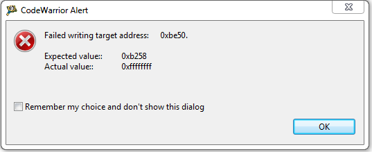

After downloading the target, another error:

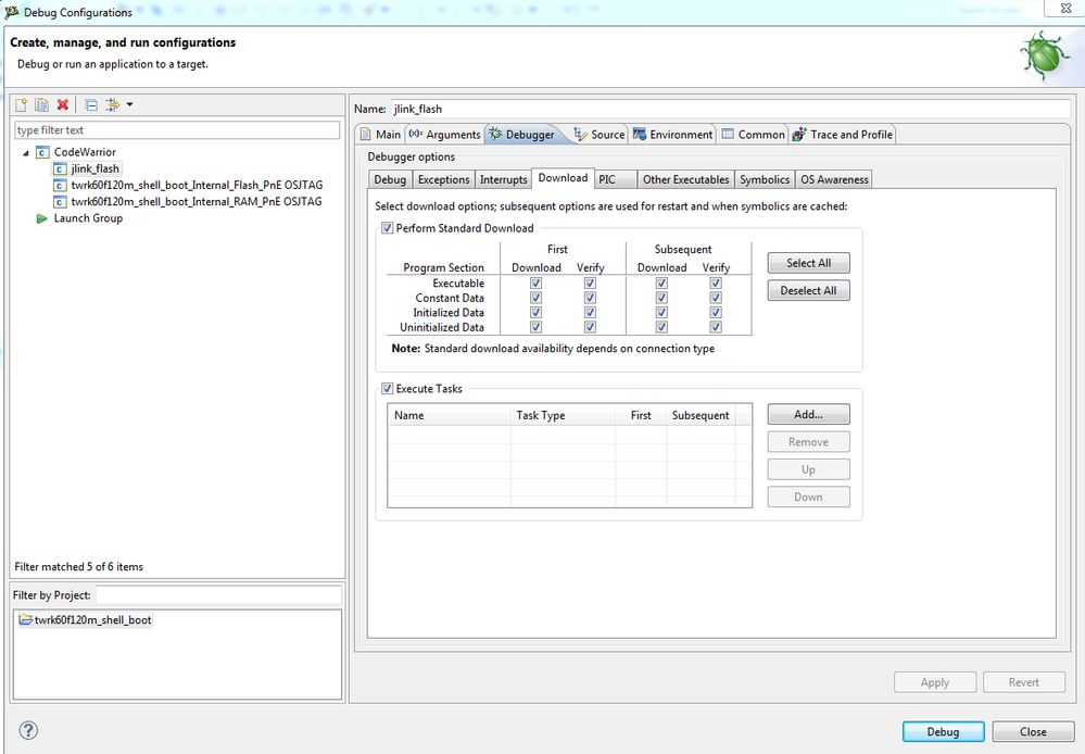

Today I find out if I don't download the uninitialized data:
Everything is fine.
But for my other projects, it doesn't have this issue. Why the uninitialized data option will have impact for this?

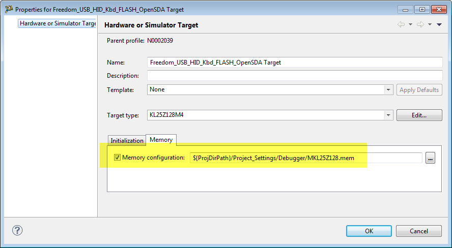

This really looks like the memory map (linker file and/or the memory map used in the debugger configuration) either not seem to match your device, or you have a hardware/connection problem.
Can you verify that the memory map in the linker, and the memory configuration in the launch config are matching?
I hope this helps,
Erich
7,541 Views
BlackNight
About the memory configuration file used: it is in the target settings of the debug/launch configuration here:
7,541 Views

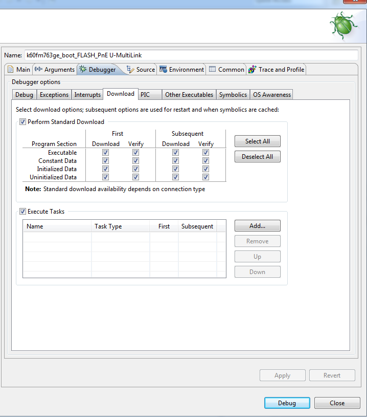

Another thought: I see that you have 'verify' enabled ini the 'perform standard download' section:
I have that on my side disabled, because the J-Link will do the verify internally too, so no need to verify things twice.
As for the selection of 'uninitialized data': if that turned on, the debugger will download all the RAM areas present in the application memory map.
Basically write all RAM areas. So if your memory map does not match the device map, issues could arise.
Erich

That dialog says 'PnE' so it looks you try to connect to a P&E Multilink, and not to a Segger J-Link?
Are you using the wrong launch configuration?
Erich
7,541 Views
cencongsu
The debug configuration is created for P&E Multilink, but I have modified the connection type to use Jlink:
7,541 Views
BlackNight

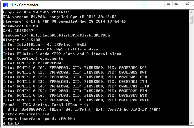

I see that you have it configured for JTAG. Are you shure it is not SWD?
7,541 Views
cencongsu
Yes, it is JTAG. The jlink can found the MCU via JTAG:
