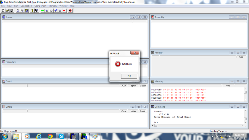

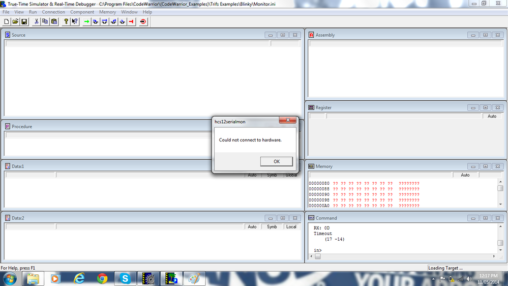

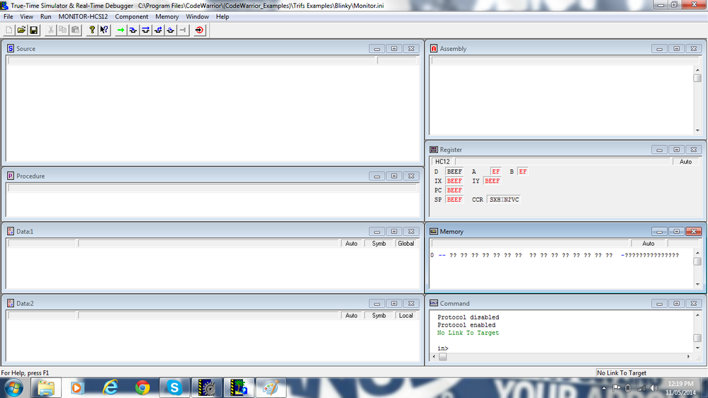

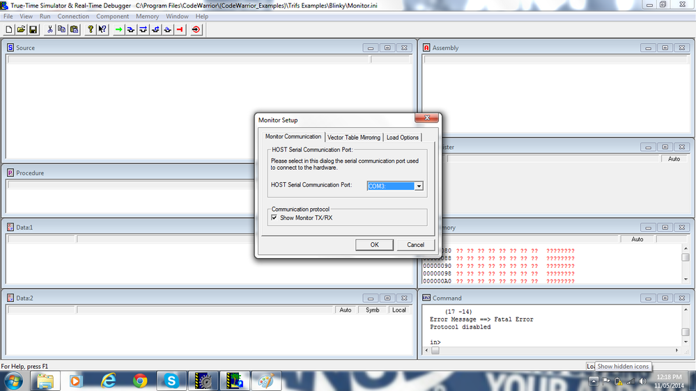

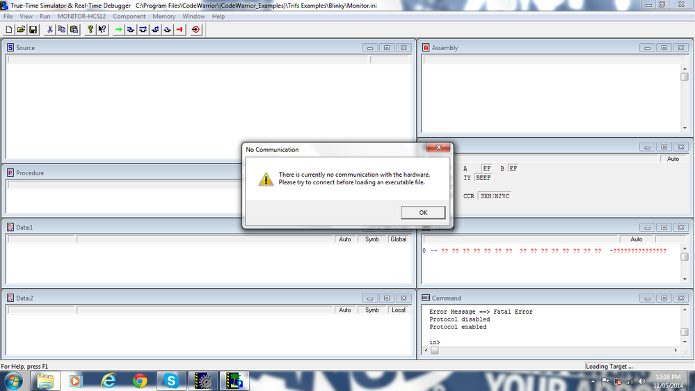

tbags
Hopefully these help paint the picture...
Codewarrior Error Screenshot.pngCodewarrior Error Screenshot 2.pngCodewarrior Error Screenshot 3.pngCodewarrior Error Screenshot 4.png

Rick_Li
HI Trifon,
Thank you for your uploaded screen-shot. by reviewing these images, you are using Monitor-HCS12 as your connection and it seems you are using Win 7 system.
as I know, CW v4.6 for HCS12 is not fully tested in Win 7 system. your connection problem might be caused by this problem.
another question: when creating a new blank project in your CW and then debugging, is this connection remains?
