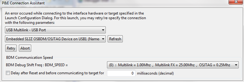

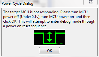

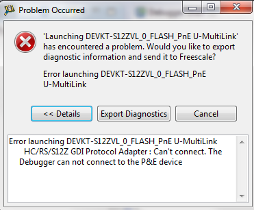

Hi community,
I'm struggling trying to debug a program using the DEVKIT-S12ZVL board and the codewarrior sw. It seems that codewarriors doesn't detect the board or that it's turned off, here is the output error:pastedImage_1.png
Notice that the computer and program actually detected the board :
   At first i thought that the board was the problem because i tried several configurations with the jumpers attached but nothing seemed to help, so i ordered another board. When tried to program the new board i get an ouput message saying that the firmware was outdated and it asked me to update it, so i did. After that i got the same behavior with the first board.
The program i'm trying to load is an example code generated with processor expert and another one was generated following the steps to make a program for de S12ZVL board. Same behavior for both.

Hello Alexis Hernandez ,
It needs  connected a 12V DC power supply on J15, then it can work well .
Hope it helps

alexishernandez
Hi Alice,
That was the problem, when i received the kit it did not came with an external power supply and didn't saw anything about that on the "Getting started ..." file. Sorry for the newbie question.
Thak you very much.
