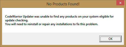

gonediving
Carlos, tried CW 10.6 and the install worked... However the CW Updater shows no products installed.
When I launched the CodeWarrior IDE, it shows that the regservers.bat needs ran to register the components:
However, when I launch the cwidec.exe from its resident directory: C:\Software\Freescale\CW MCU v10.6\eclipse\cwidec.exe I get the app to come up in CodeWarrior Development Studio.
I made a test build which went through (but with typical coding errors at build time)
However, this only gets me the IDE for an EVAL copy. I will resurface on the CW License forum. I need to link this to a float license server to unlock this EVAL copy.
