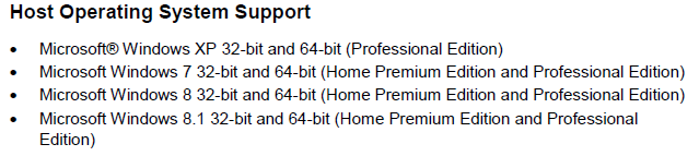

NXP has both classic CW6.3 and eclipse CW10.6.4 can support 8bit MCU QG8.
However officially both of them don't support win10
Here is the Operating system requirement for CW6.3:
here is for CW10.6.4
fortunately,  I know there is a hot discussion about how to Install CodeWarrior 6.3 Windows 7 & 10 x64 directly (Classic version). please check if this can help you
