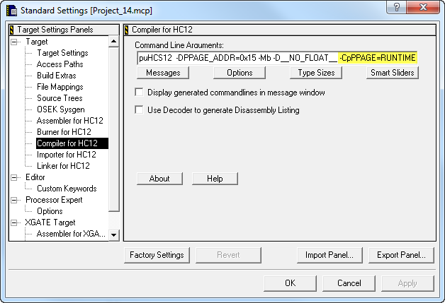

When I configure IntEEPROM part, a error message occur: ERROR:Compiler option -CpPPAGE=0x15(address of Ppage) or CpPPAGE=RUNTIME must be set to comiler the generated code correctly(current target settings,compiler for HC12,option,Code generation tab,PPAGE register is used for paging......)......
How to do it ?

Hi Cang,
to solve this problem, please add  -CpPPAGE=RUNTIME to compiler settings that can fix the problem. see attached screenshot.
can this help you?
