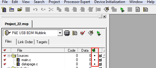

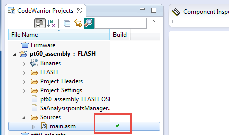

Hi Andrew,
In addition, can you check if the objects definition files are included in the build?
in classic CW
