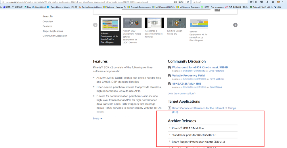

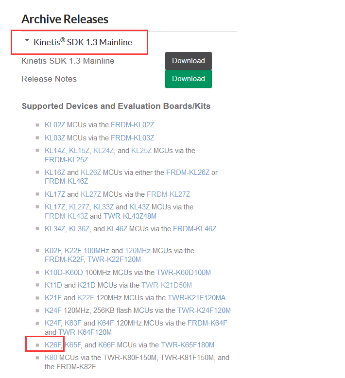

Hello Fred,
- You can find the KSDKv1.3 at here :
Software Development Kit for Kinetis MCUs|NXP
THe  kinetis SDK1.3 Mainline version includes this k26 :
-About install KSDK into KDS, please refer to the DOC under KDS:
KDS_v3\doc\KDS_Users_Guide.pdf  ->4.2 Installing Kinetis SDK into KDS
