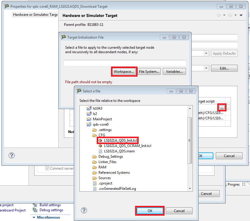

Hello
I am trying to bring up a new board based on the T1020.  I have connected to the target using code warrior JTAG RCW override.  When I connect to the target this way, code warrior does not give me the option to initialize the cpu (I want to use a modified T1020RDB_core.tcl configured for our target to burn the RCW into NAND flash).  Is there a way to do this?  Note.  The target board is to use the Hard coded RCW (with this method, the initialization option is avail)
Henry Eng
1,494 Views
addiyi
After you select the jtag_chain file as Target Type, you can add the init file as in below image:
