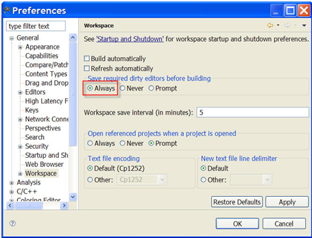

To instruct the CodeWarrior IDE to save changes to your source code files automatically before building the project, follow steps below:
  1. From the C/C++ perspective toolbar, select Window > Preferences .
The Preferences window appears.
    2. Expand General .
    3. Select Workspace
    The Workspace settings appear.
    4. Under Save required dirty editors before building , select the Always radio button.
5. Click Apply .
6.Click OK .
Hope it helps! If not, could you please attach your project to help us reproduce the problem? Thank you.
