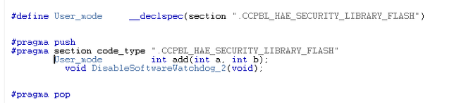

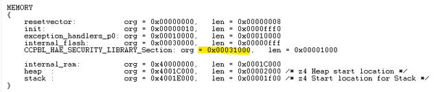

I made Library but I have one more question.
I wish to locate the dedicated area about Library.
I tried to use some pragma function like below.
The function of same code file is possible to locate on my dedicated area.
However, the library function is not located on my dedicated area.
for your understanding, I have attached project...
I wish to locate the function and library into 0x31000.
I tried to do like below.
However, only function of same file is located on 0x31000...
how to locate the library into 0x31000?
Thank you.

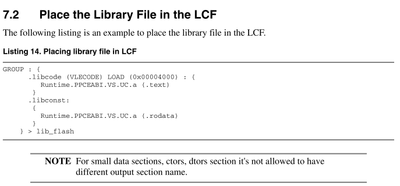

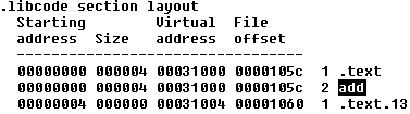

lukaszadrapa
Hi Luke,
I found quick solution in AN4497:
I did quick test in your project, so I added this to the linker file:
GROUP : {
.libcode (VLECODE) LOAD (0x00031000) : {
test.a (.text)
.libconst:
test.a (.rodata)
} > CCPBL_HAE_SECURITY_LIBRARY_Section
And here's the result:
Lukas
