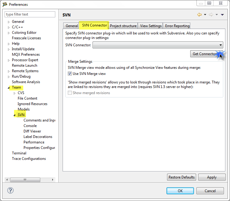

Guy's guy's guy's,
Looking to install support for Subversion in Codewarrior 10.6.4.  CVS appears to be installed and taking priority.  CVS is really on the way out.
The SVN provider installs but can't get the connector auto discovery to work. and therefore no connector.
Please advise.

After installing the Subversive SVN team provider plug-in you can go to menu Window > Preferences > Team > SVN > SVN Connector tab and click on Get Connectors:

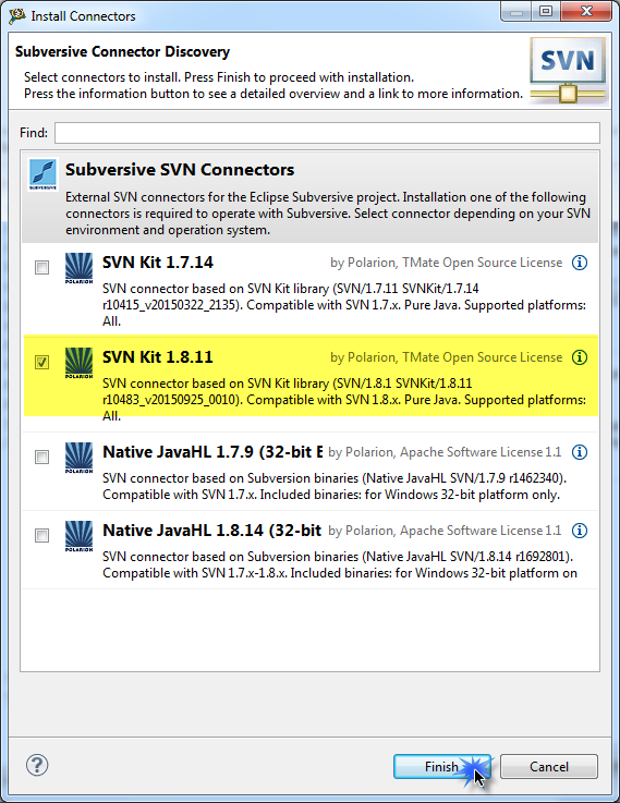

Select the SVN Kit 1.8.11 which is the latest version, click on Finish and continue with the installation:
