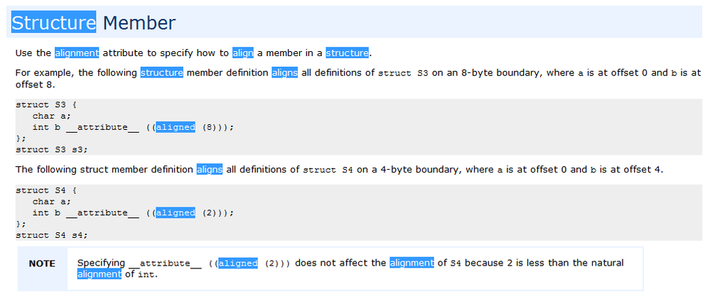

I want to force the data flash to 1 byte aligned.
Who can help me, thanks in advance?

please look at the example in the attachment. It shows, how to place constants to flash.
About Alignment, please see following figures:
This information could be found in CodeWarrior Help.
Martin

Sorry to reply you so late.
Yes,i want to place some structure constants to flash and align it to 1 byte.
