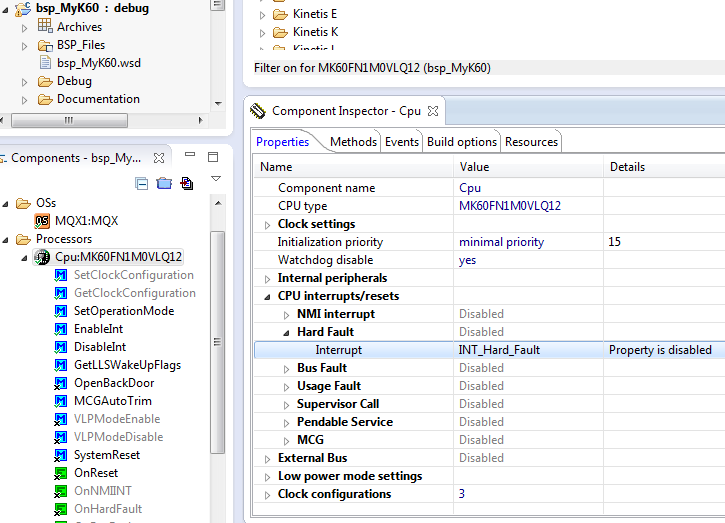

I have K60 tower board. I have MQX 4.2 and Code Warrior 10.6.4.
I want to generate code for Cpu_OnHardFault ISR using PE, but it is disabled. I am not sure there is any way to enable it for generate code:

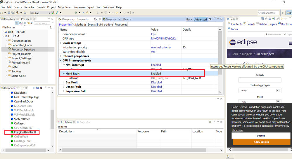

ZhangJennie
Hi David
This feature is automatically enabled when the hard fault property is set to "Enabled". see below screenshot.

Thank you for your reply. In my PE, all the interrupts are disabled, and I cannot find a way to enable them. See the screen pasted below:
When I left-click the OnHardFault, there is a popup menu to toggle Enable/Disable, but it is GRAYED.
it must have another level of enabling it. I don't know the small green icon with a little cross on it. Enabled ones are blue with a check.

BlackNight
Hi David,
I agree that this might be confusing. But the it means that the *property' is disabled and cannot be changed, as the HardFault cannot be disabled. So it is turned on anyway by the hardware as it is a non-maskable interrupt.
I hope this helps,
Erich

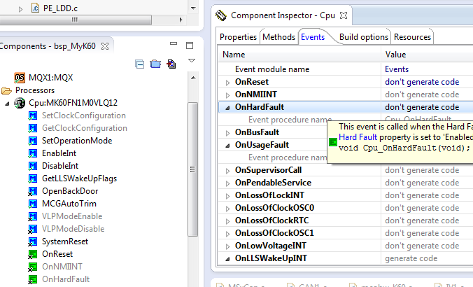

davidzhou
Contributor V
Hi Erich, Jennie,
Thanks for explanation. But I still don't know how to enable it as Jennie's saved screen with ENABLE to generated code for the HardFault ISR. From my screen pasted, all those functions are disabled, AND I have a no way to ENABLE them. That results in preventing me from generating code for them. I understand they are non-maskable interrupts, currently are all tied into _int_kernel_isr. Do you mean non-maskable interrupts can not generated code from PE? But then why Jennie's screen shows enable and be able to generate code?

BlackNight
Hi David,
I think the reason that you cannot enable it the usual way is because you have MQX in your project: MQX takes ownership of all interrupts.
I hope this helps,
Erich

davidzhou
Contributor V
Erich,
Thank you for the answer. That explains. As I have said I have manually installed the ISR, it is not a problem for me.

davidzhou
Contributor V
By the way, I have created  a function CW_InstallIsrHardFault and manually installed ISR for the OnHardFault as follows:
uint32_t CW_InstallIsrHardFault(INT_ISR_FPTR isr) {
    INT_ISR_FPTR fpISR;
    fpISR = _int_install_isr(3, isr, (void *)NULL);
    if ( fpISR == (INT_ISR_FPTR) NULL ) {
        return 1;
    return 0;
