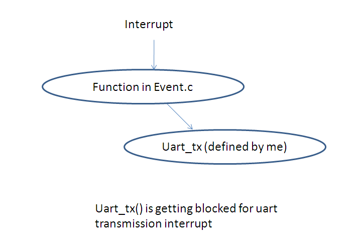

I am using kinetis kl25z controller and CW10.3 IDE for my project.
In events.c file, I have called a function(uart_tx) that sends the data over UART. uart_tx() is getting blocked for uart transmission interrupt.
I guess the problem was due to disabling of nested interrupts. Your information regarding how to enable nested interrupts in CW10.3
for kl25z will be helpful for me

Are you using Processor Expert? Can you please share the structure of the Events.c file?
Thank you!
Adrian

the nest interrupt is automatically managed by Nested Vector Interrupt Controller.  please see attached doc
Zhang Jun
