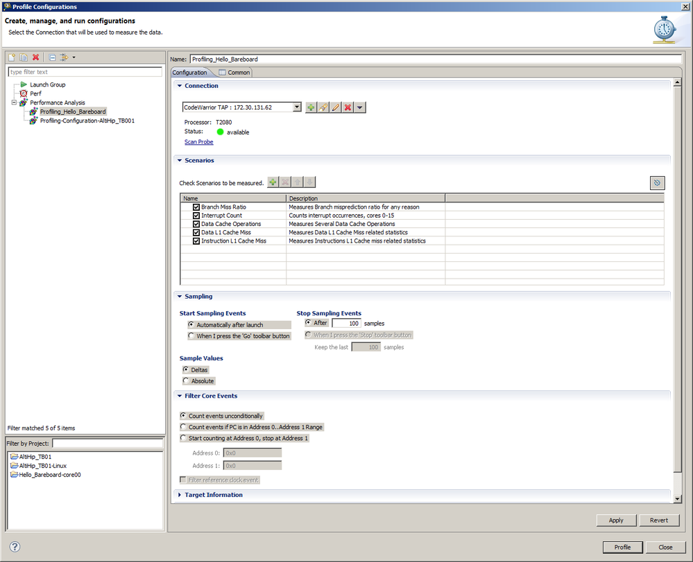

when I prepare for a performace analysis I have to setup a proper Analyses Profile.
What I am wondering about.
In the Connection Tab I just specify the jtag debuggers connection (CodeWarrior TAP with Ethernet IP in my case), but no further target settings, like target initialization.
Does the Profiling Session sit on top of an actual Debug Session? So that it takes/uses the current Debug Session's Connection and Target settings?
Actually I want to make sure that my target initialization for cache enable an dynamic branch predication ist applied during performance analyses.
I use CW for PA 10.4 with an T2080RDB target.
regards
Alois

I assume you want to profile a specific application. The way to do this is to start the application in
debug (and you specify the target initialization file in the debug configuration). After download, the code
will be stopped at main(). In this moment start you profile configuration and then resume the target.
If you just run your profile configuration without starting an application first, you can do it, I just tried on
my 2080 setup, but you will not get valid data.
regards,
Catalin

aloishahn
Hi Cataline,
now I tried simple bareboard example, as generated by the wizard (t2080rdb, 32bit, C Code).
The example works fine in the debugger.
At main() I run a profiling session, with same CPU profiling (Branch miss Ratio, Interrupt Count, Data Cache Operations).
Unfortunately I receive all zero results all the time.
Even when adding loops with memory access and cache enabled, still all profiling registers are zero.
Have you any advice or some kind of working example to compare with?
regards
Alois
this is my profiling setup

aloishahn
Hi Adrian,
thank you for the examples, they are very usefull.
My starting questions/issue has been solved in the meantime as well.
It was due to a misunderstanding from my side, about how the profiling sessions would start a debugging session.
Actually the profiling sessions does not care for starting/running the application code. It requires a target which is in run state already.
So in that context the question about target initialization for profiling does not make sense.
Alois
