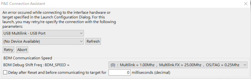

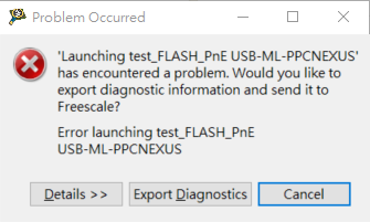

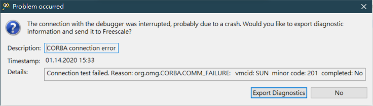

When i press Debug in CodeWarriorpastedImage_4.png, it show pastedImage_5.png, i press OK, and next
pastedImage_6.png, it is show P&E Connection Assistant and pastedImage_7.png and pastedImage_8.png.
It seems not work.

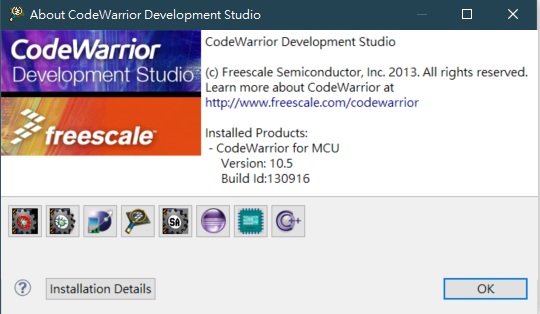

Provide my CodeWarrior version

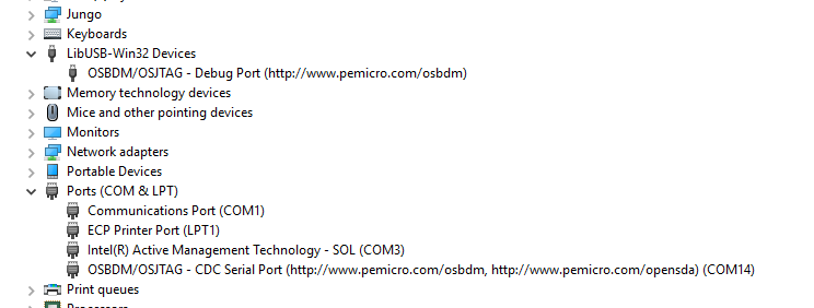

if I connect TRK-MPC5604B using USB cable i see following in the PC device Manager
then within CW 10.5 target setting I can select OSBDM/OSJTAG and it is available in Port option
BR, Petr

within P&E Connection Assistant select "OSBDM/OSJATG" option, if it is there, as you are not connecting through USB Multilink.
BR, Petr
