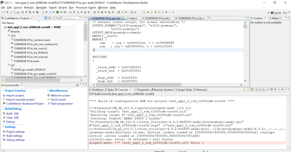

Hi @yipingwang ,
Currently I'm working on the T2080RDB,I have created the ROM version of the project and created the boot.bin file with using the mentioned command.
I have flashed the PBL.bin at the starting address 0xE0000000 and the boot.bin file in the 0xE7F00000 where my unprotected region of my NOR flash is 0xE0000000 to 0xE7FFFFFF and the protected region is 0xE8000000 to 0xEFFFFFFF.
After that I can able to flash but the booting is not happening.
I have created the ROM version of the project in the codewarrior , while debugging the project it not stopping in the main function.
Can you tell me how to debug the ROM version for the codewarrior?
I have done the modification in the T2080RDB-PCIe_gcc-aeabi_ROM.lcf . I have attached the lcf file with the modification have some errors mentioned in the screenshot.
Can you tell me any other configuration have to do for the booting have happen?

yipingwang
Please define lcf file as the following, and program the bin file at 0xEFF00000.

Vimalprasad
Hi @yipingwang , thanks for your response.
In my nor flash the address start from the 0xE0000000 to 0xE7FFFFFF is in unprotected and the address from 0xE8000000 to 0xEFFFFFFF is in protected mode.
I have tried to flash in 0xEFF00000 , it showing write protected error, flash not happened.
So, I flashed at 0xE7F00000 but the booting is not happening.
Where I have to flash my boot.bin file so that it can boot?
In this T2081QDS_gcc-aeabi_ROM.lcf file any modification have to do , can you tell the modifications?
