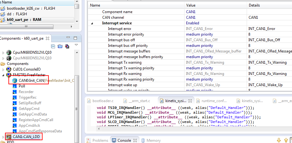

Hello Kidd,
Which chip do you used ? Does it have two CAN module ?
For k60 example , it have CAN0 and CAN1, so it can use at the same time :

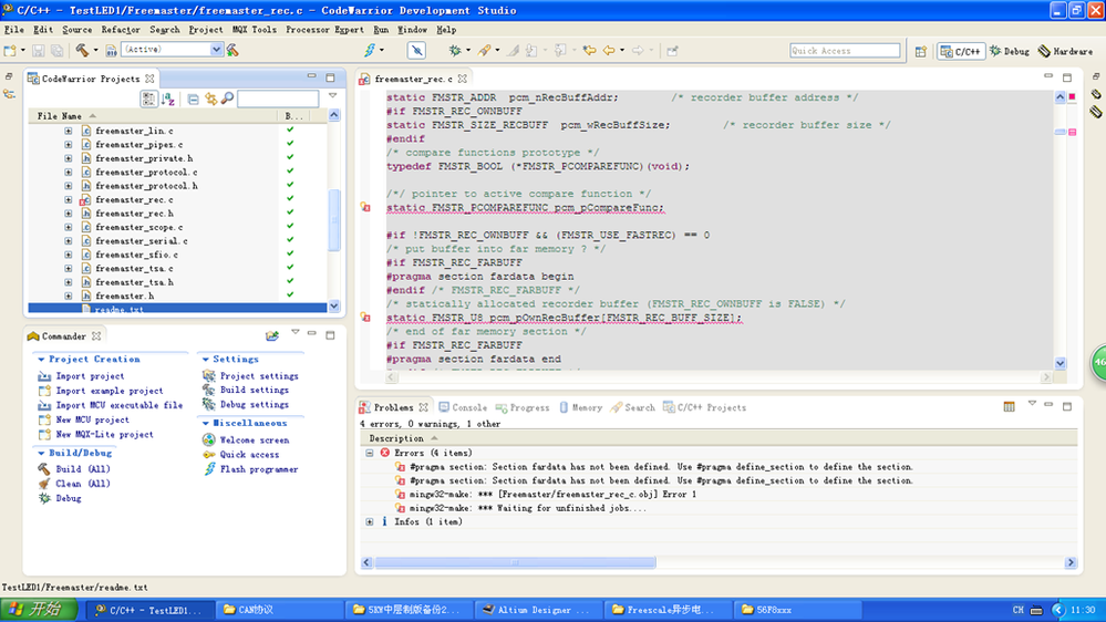

I have tried to do that and there come out another problem. After I configured CAN module by PE successfully, then added freemaster's driver(for 56800E), and compiled, there would be error like this.
Compared with code generated by PE, the code which had errors in picture above was totally same. But there was no error in the PE code.
WHY? Is this a BUG of code warrior 10.6 or PE system???

The code of your Freemaster's driver implements the same functionality with the code generated by PE Freemaster component.  You can only choose one of them.
The link error on your screenshot shows that the section ‘fardata’ is not defined.  It should be defined with the code like #pragma define_section fardata ".fardata.data" RW
