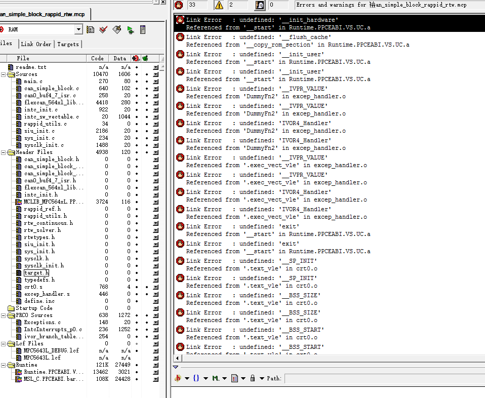

     I want to  build a MPC5643L CodeWarrior project using codes  generated by toolbox,   but there're some errors I never met .Can anybody give me some suggestion to configured the CodeWarrior project?

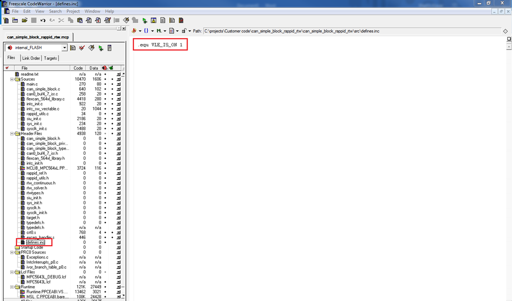

At first, if you use conditional translation in assembly file, you must create specific file for symbols. Please see figures below.
I created defines.inc file and I added this file to your project. In this file I created symbol VLE_IS_ON 1 which you use in crt0.s
Second step is to tell to EPPC Assembler there is defines.inc file. Click project settings, select EPPC assembler, check Generate Listing File and choose the file.

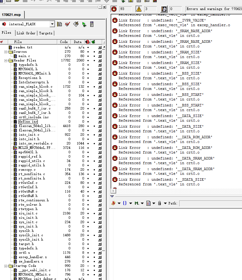

After this steps are done, there are another compile (linker) errors, because in crt0.s file you use linker symbols which does not exist in linker file. You have two possible solutions. First one is to define this symbols in linker file, second one is not use symbols only symbols defined in linker file.
In general, it is not good to mix these two project together, because there another dependencies like exception and interrupts settings and some other and this could cause some other issues.

Hi Martin,
      I try to define the   crt0.s file  symbols  in   linker file  once more ,but don't succeed.Can you give me some suggestions to complete  it?

when you look at the linker file, there are some symbols defined by default:
_stack_addr = ADDR(stack)+SIZEOF(stack);
_stack_end  = ADDR(stack);
_heap_addr  = ADDR(heap);
_heap_end   = ADDR(heap)+SIZEOF(heap);
So for example, if you use symbol called __SP_INIT in your project, you must define it in linker. It should look like:
__SP_INIT = _stack_addr;
Now it is up to you to create all necessary symbols and assign correct addresses to them.
