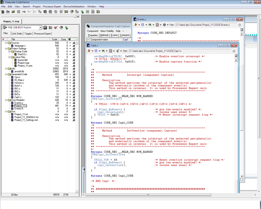

ZhangJennie
hi KDN,
processor expert implements interrupt in different style.
see project "TimerInt", "Capture" under
C:\Freescale\CWS12V5_1\ProcessorExpert\Projects\Test projects.
processor expert defines interrupt vectors table in file vectors.c.for example, capture interrupt function in vector table is "Cap1_Interrupt". then we can write the related interrupt function inside ISR(Cap1_Interrupt)

kdn
I have written my code in Cap1_OnCapture(void) , call my ISR(Cap1_interrupt) , but it's not working

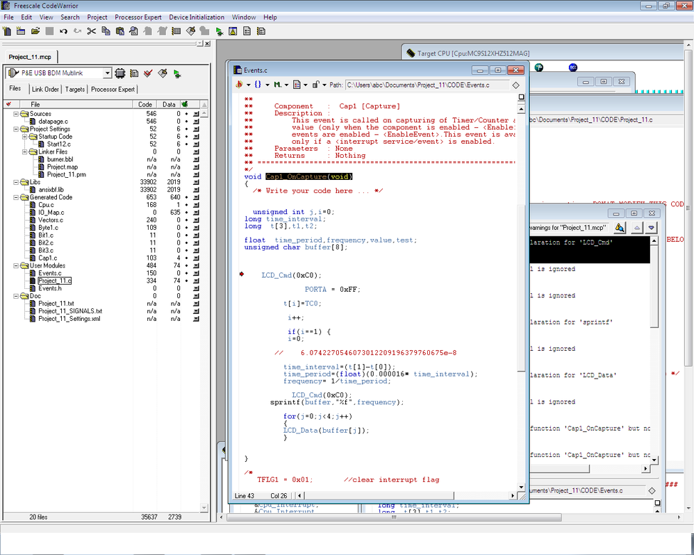

kdn
I done debugging and check that variable k is not increment, I shown that variable in pic below with circular.

ZhangJennie
pls try to set k as local variable and cast it as volatile.
volatile int k=0;
