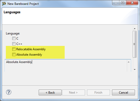

Hello. Which version of codewarrior to work in assembly with MC9S08PT60.Best regards, Barbosa

please use CW10.6.4 that can support MC9S08PT60.
you can create a new assembly project with wizard, with choosing assembly options:
can this help you?
