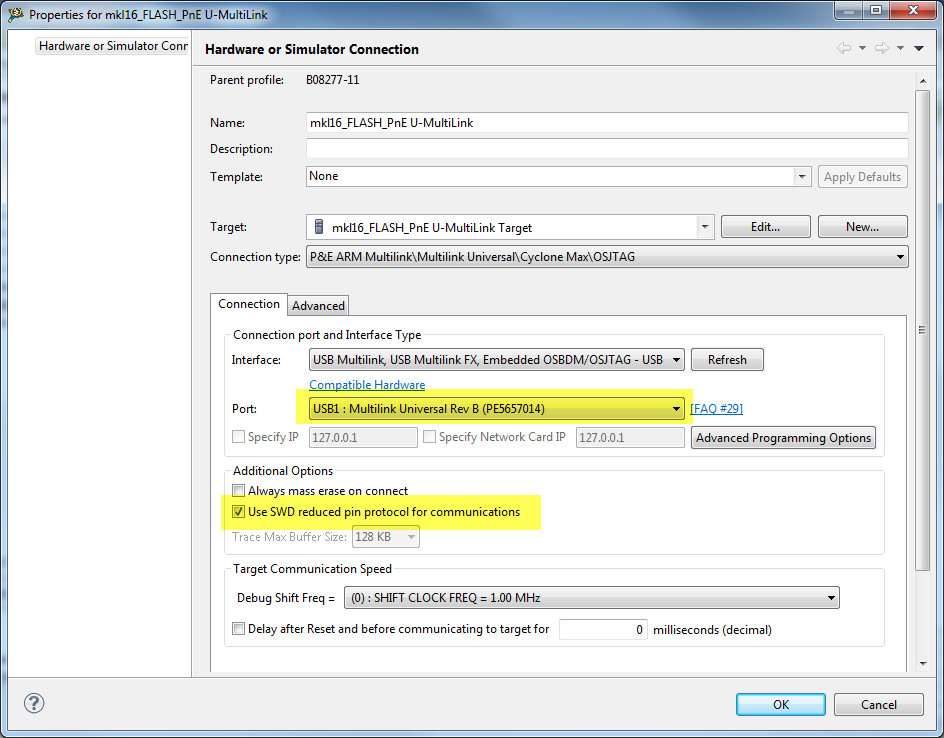

I am unable to get the P&E Multilink Universal to communicate with a MKL16Z256 uP when using CodeWarrior 10. It works fine when I use it with Kinetics Development Studio so I know the hardware and physical connections are OK.

What am I not setting up correctly???

1. what's your CW10 version? I suggest you use CW10.6.4 from this url:
CodeWarrior for Microcontrollers-Eclipse IDE|NXP
2. make sure you have Multilink universal selected as port. if you use 10pin SWD reduced pin protocal, have it checked in additional options:
3. I also suggest update to the new multilink universial firmware.
http://www.pemicro.com/downloads/download_file.cfm?download_id=346
USB Multilink Universal Resource CD (10275 KB)
4. make sure there is not other board connection still alive when connecting CW.
5. at last, i suggest you check Erich's article:
Debugging Failure: Check List and Hints | MCU on Eclipse
can this help you?if not, please post your problem screenshot.
