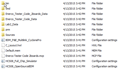

michaelmullins
Hi Carlos,
I have CW 6.1. I am not sure what steps to take. I have files generated from the company who built the tester and I'm not sure how to send them to the demo board.
Could you please give me a step by step how to load the program into the board? Here is what i was sent.
2,548 Views
TICS_Fiona
The File with extension name "*.mcp" is the Classic CodeWarrior project, please open from in CodeWarrior "File -> Open" menu, or drag it into CodeWarrior IDE to open the project. Then click on the 'Build' button for compiling & linking, click on the 'Debug' for programming and debugging.
